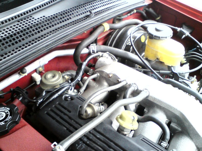

  • I don't think that the Puffo will decrease your IAT values.
    The IAT sensor is affected by ambient heat of the intake manifold.
    IMHO this is the reason why the ECU retards ignition at warm temperatures.
    To ensure that the IAT puts out the correct temperature why don't you try to move the IAT from the intake manifold to another place where its not affected by ambient heat.

    Original von patrick_S
    i can't imagine that the position of the IAT sensor should be a fail made by Honda
    Just compare your IAT values via OBD before and after relocating the sensor and you'll see, that the stock position of the sensor is a constructive error.
    Think about the Hondata gasket or think about why Hondata uses the Integra IAT for the Kpro in the S2K.

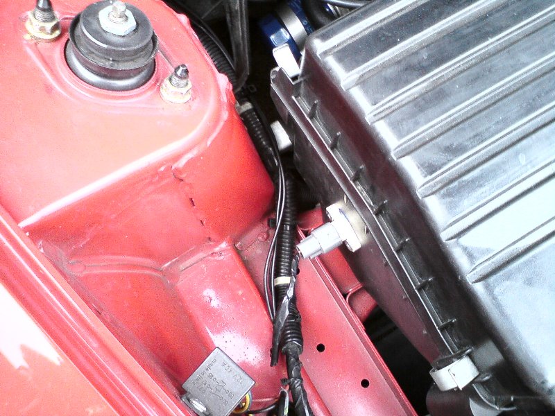

  • I think it's not that complicated.
    The early s2k's IATs read 15-20 °C to hot.
    Put your IAT to another place (like Honda did in the later versions) and everything is fine.
    Mine is now located on the left side of the OEM-airbox.
    Dr. Emmett Brown
