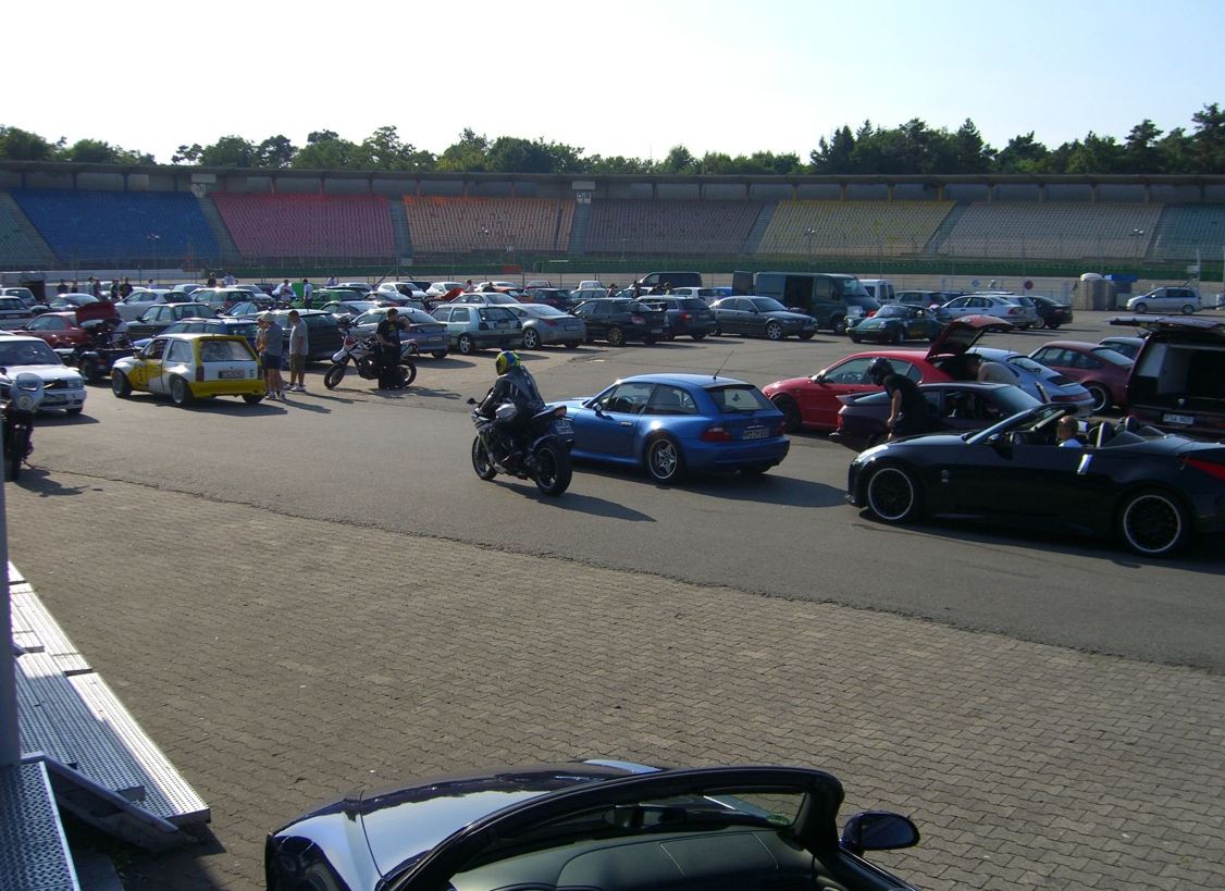

Hey everyone!
I'm gonna be driving at the Hockenheimring on Thursday the 20.08 from 17:00 onwards. Anyone interested to join me and my S?

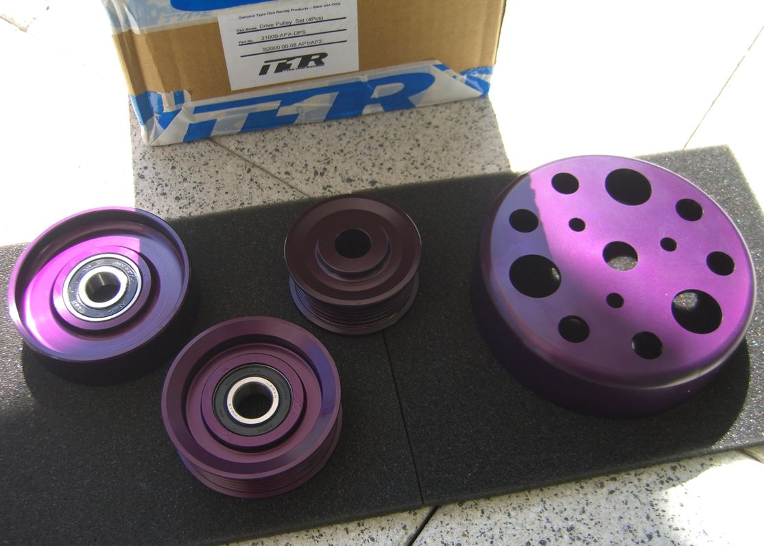

Bought this last year sometime and I never got around to mounting them. I've got a couple of new ideas for my S, so I don't need the pulleys anymore!
If anyone is interested just let me know.
Price:190 Euros including shipping.
