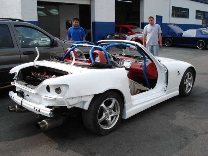

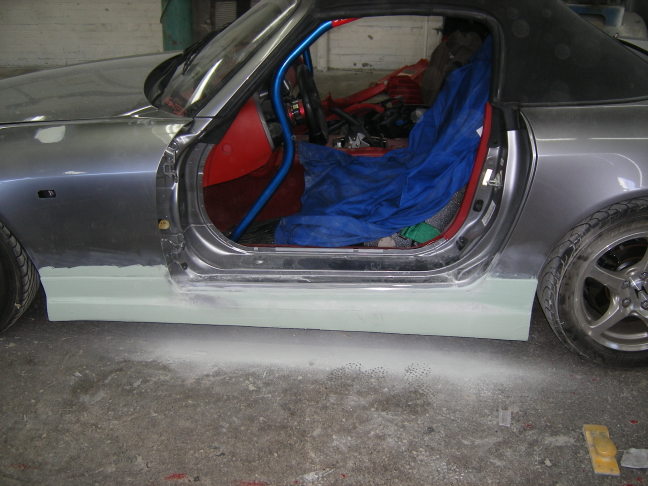

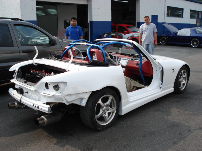

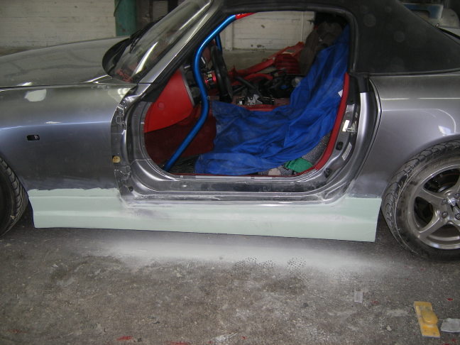

Use the pics provided to get a feel for where the legs go and put the bolt through the mounting points on top and mark your location with a sharpie before you drill - Take a step back take a deep breath and see if everything looks symetrical and in place, even after I took the time to do it right, It was a pain in the ass to get the Legs to line up, it took quite a bit of tugging and pulling to get the bolts up top through.
