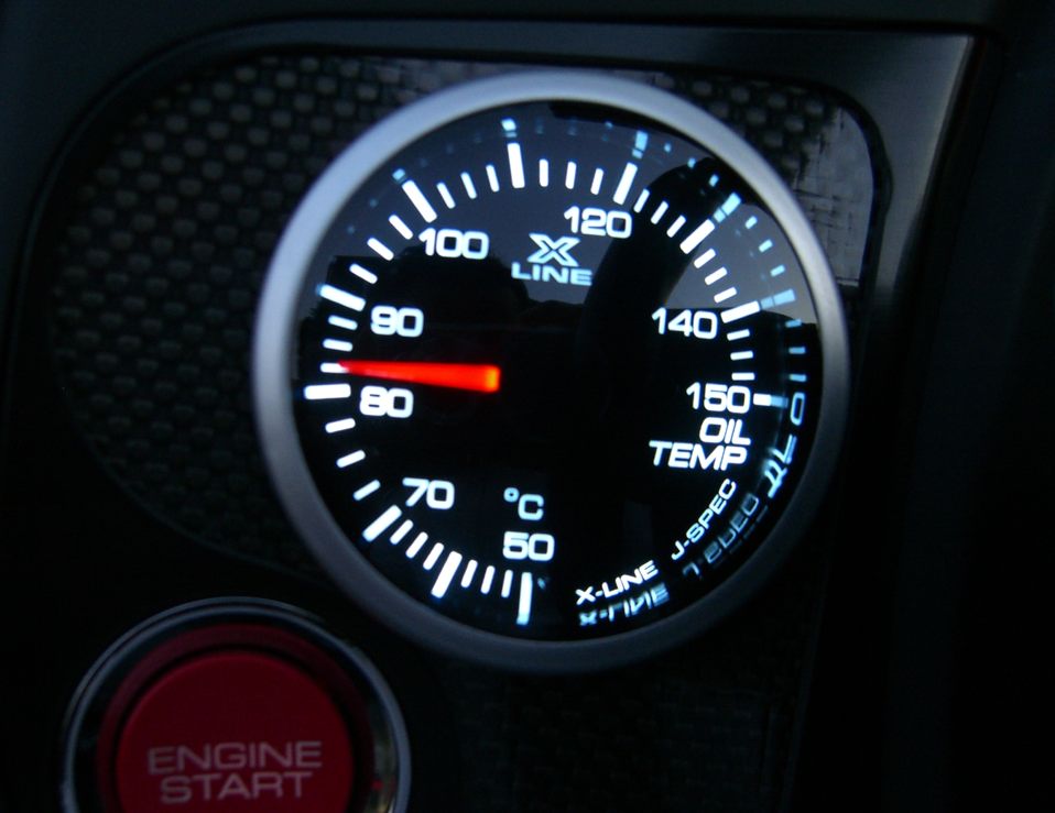

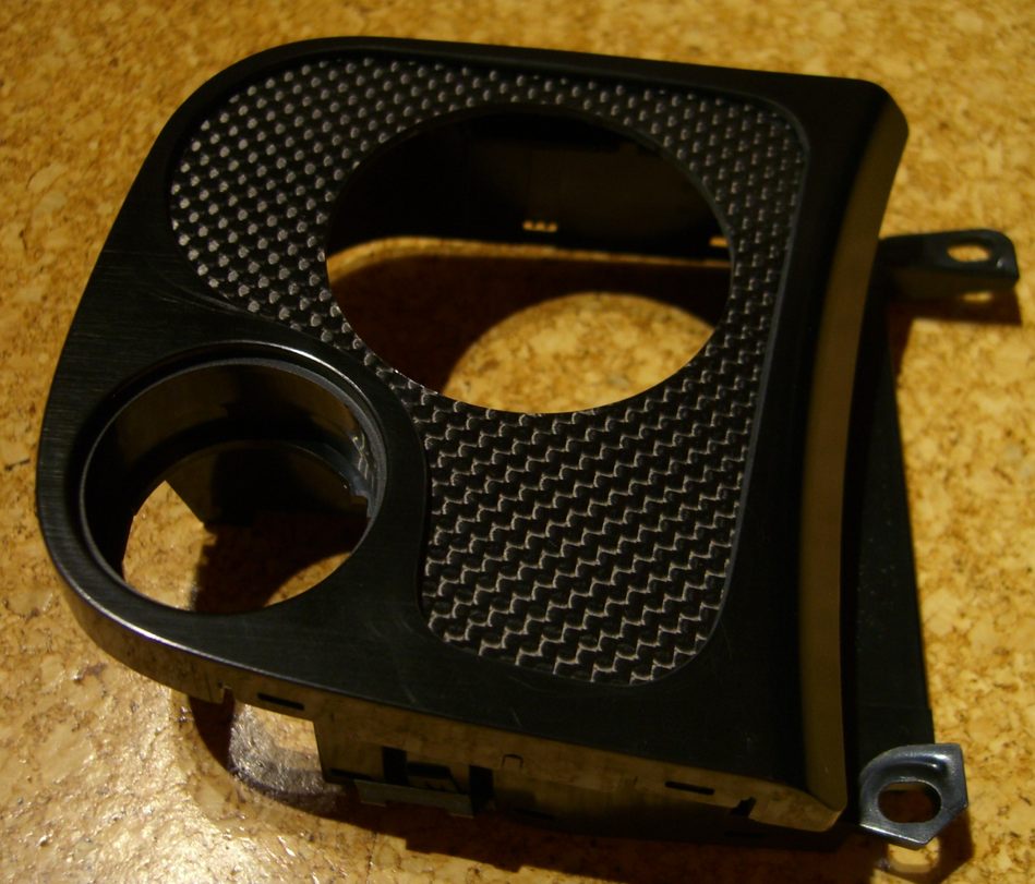

    I've gotta keep this international thread hot so here is something to check out........ my new mod for my S is an oil cooler with two gauges, oil temp. and oil pressure. I'll post more pictures when it's 100% finished but here is a teaser pic.

    Hi Fran!
    Nice mod!
    Can U please make a few pics of the cooler itself and the sandwitch plate?
    Take some brighter pics from the gauges as well!
    :thumbup:

    Nice!
    Where did you get the carbon plate from ?!

    I choosed the same place for the gauge ( but only oil temp. )
    Which manufacturer is the gauge from???

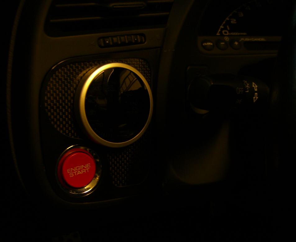

    Sweet! carbon fiber FTW! :)
    Dude, it looks like your starter button is at an angle :roll:

    The oil cooler is from Setrab, a Swedish company. I'll post detailed pics next week when all is done.
    @Stocky
    The carbon plate is from my local RC shop. Good old 2mm thick carbon from Graupner!
    Pipo 2000
    The gauges are from STRI with a white LED backlight.

    Yeh, that's what I thought but perhaps it's just the angle I took the photo. The starter button snaps in place only in one direction/angle so I don't know how to refit it, if it needs to be refitted :roll:

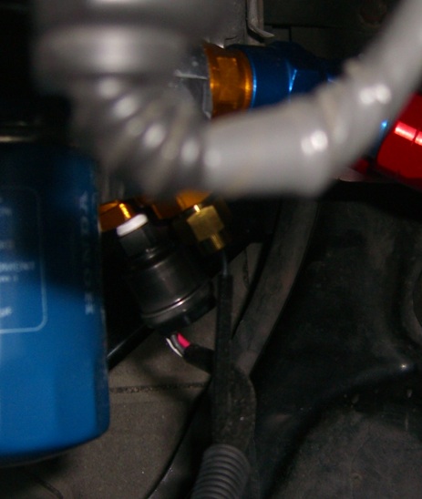

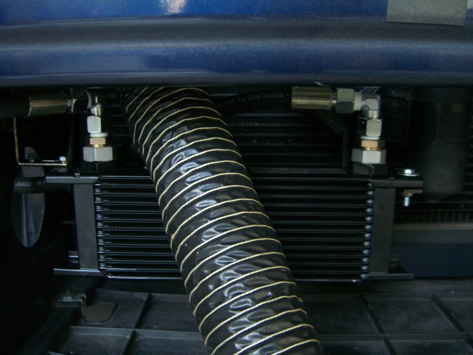

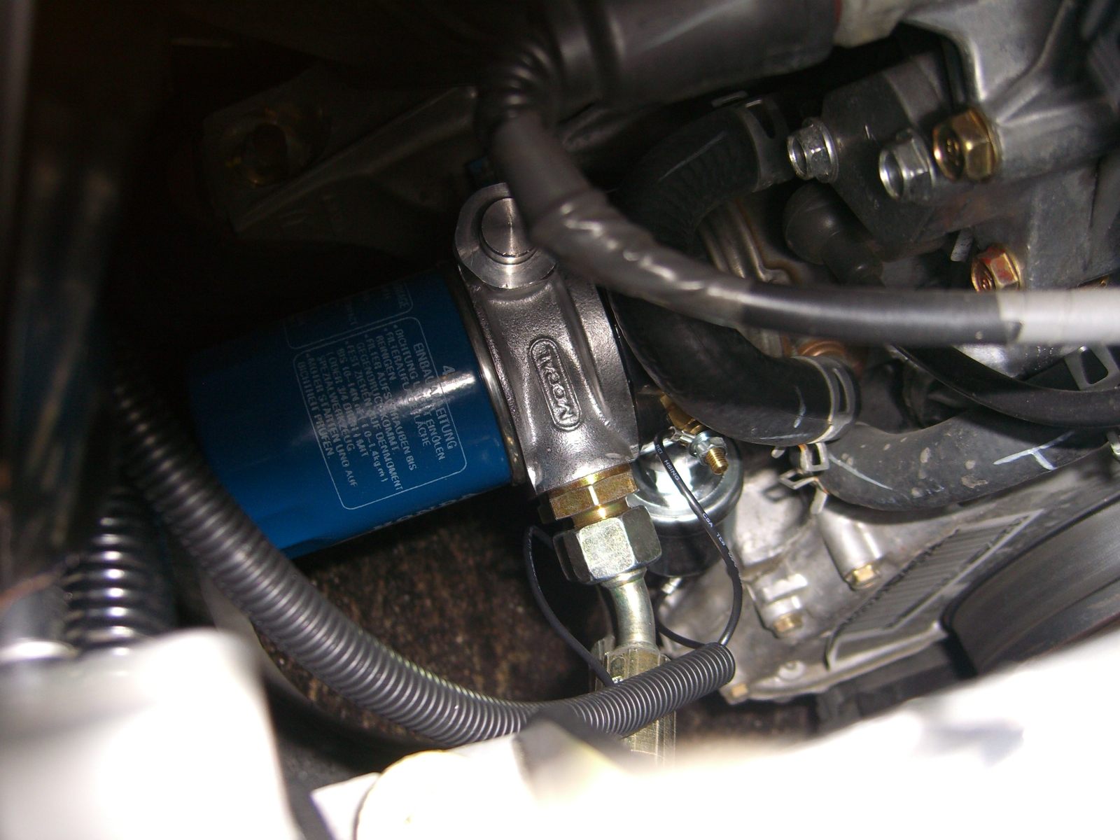

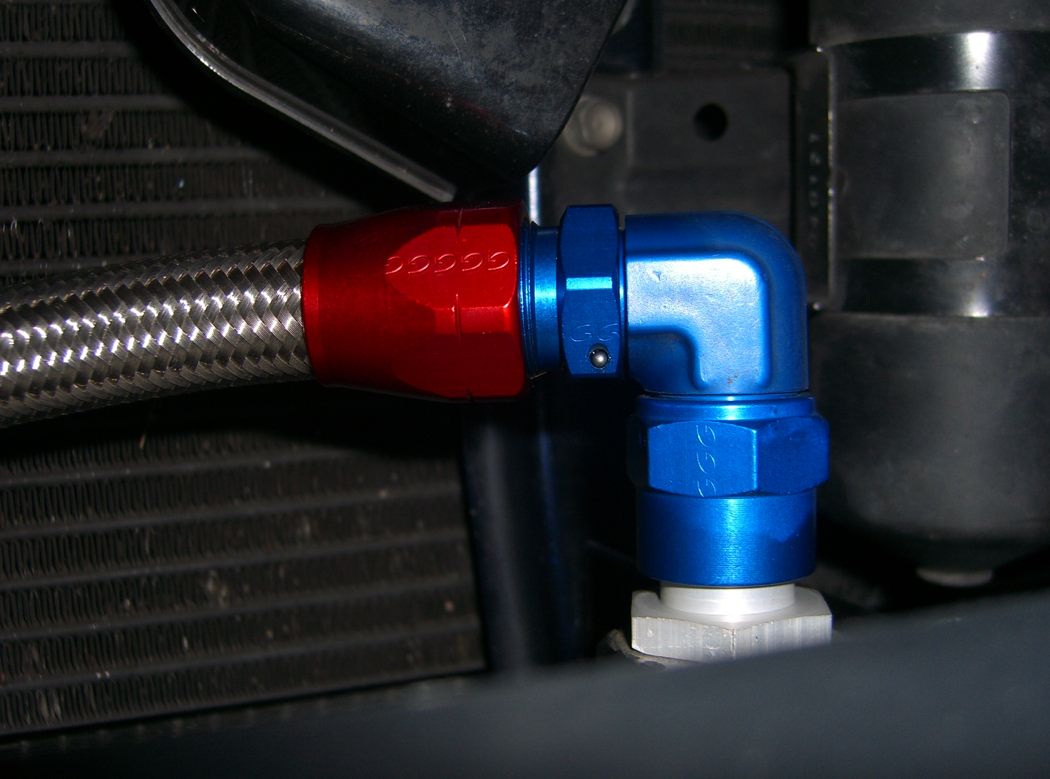

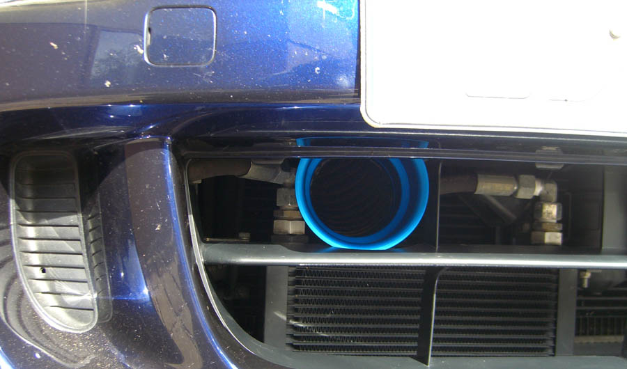

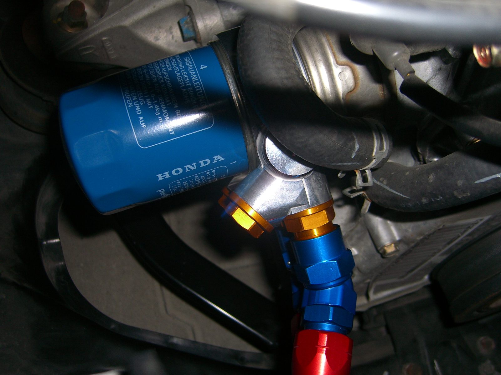

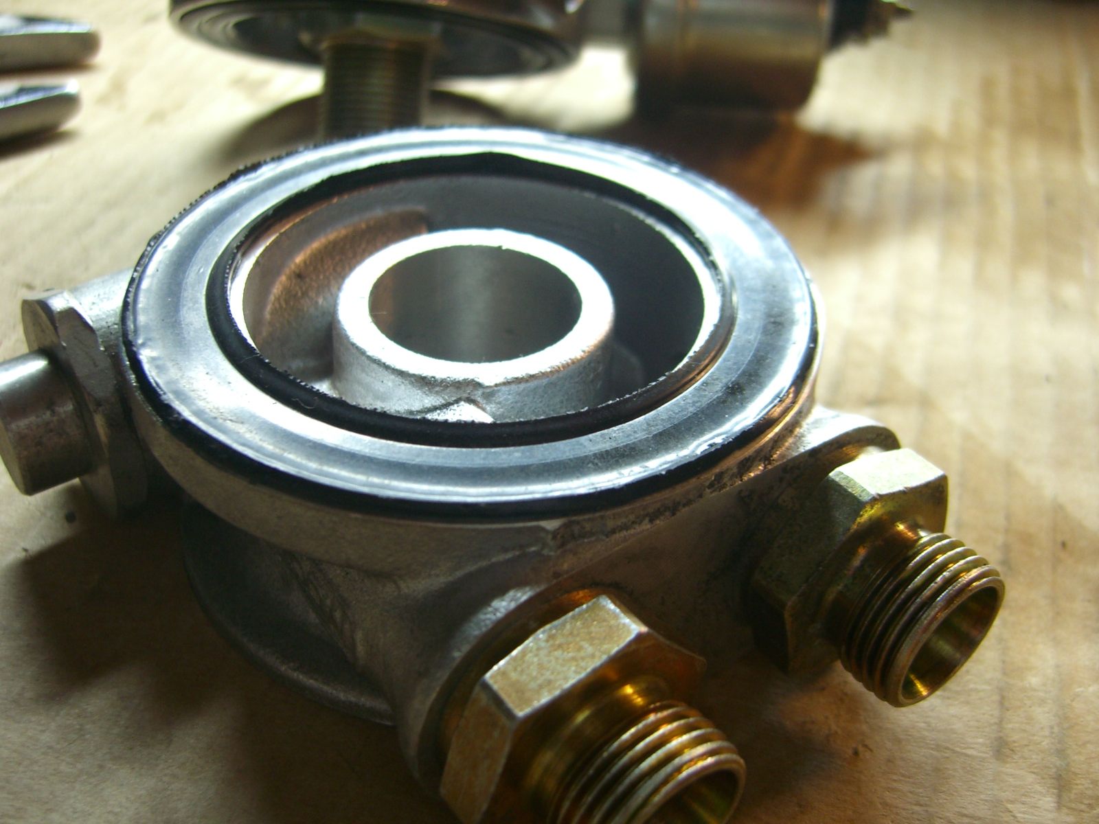

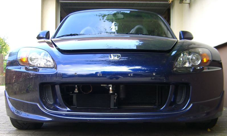

    So here is my conclusion to the finished oil cooler set-up.....
    Specs:
    Oil cooler: Setrab 13 rows
    Oil sensor adpter: Greddy
    Gauges: STRI led backlight
    Gauge pod: SOS single gauge pillar
    I took the S for a test drive today and the first thing I noticed is that the two gauges do not distract my driving view. Good news because in the beginning, I thought of mounting both gauges on the A-pillar, I happy that I didn't!!
    So, with a 10 minute warm-up the oil temp was somewhere at 50 degrees and only after driving around for another 3 minutes did the temp gauge start to move. After a good 15 minutes the oil was up to 75 and it was time to push it!
    What I noticed was the oil reached a maximum of around 92 degrees after 15 minutes of country lane driving. I did not drive on the motorway but I would guess that the oil temp would say close to the 90-95 degrees.

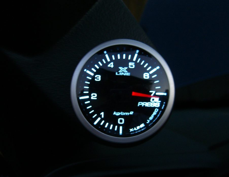

    The oil pressure gauge is a question mark for me :?: On idle it reads at around 3 kg/cm2 which is normal I believe and when the rpms pick up, the oil pressure follows.
    So, everything sounds good you say but what I noticed when I'm driving is that the oil pressure stays at 7 kg cm2! The needle looks as if it wants to break off. Is this correct!?! :roll:
    Does anybody know if the oil pressure reading is correct?
    Apart from this question, the whole oil cooler set-up is awesome! :D
    Here are the pics. Enjoy! :)

    More pics.....
      • 197,86 kB
      • 1.600 × 1.200

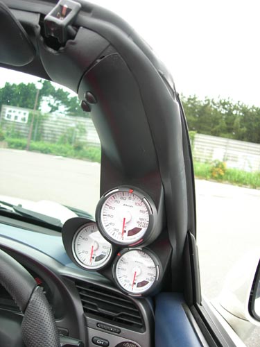

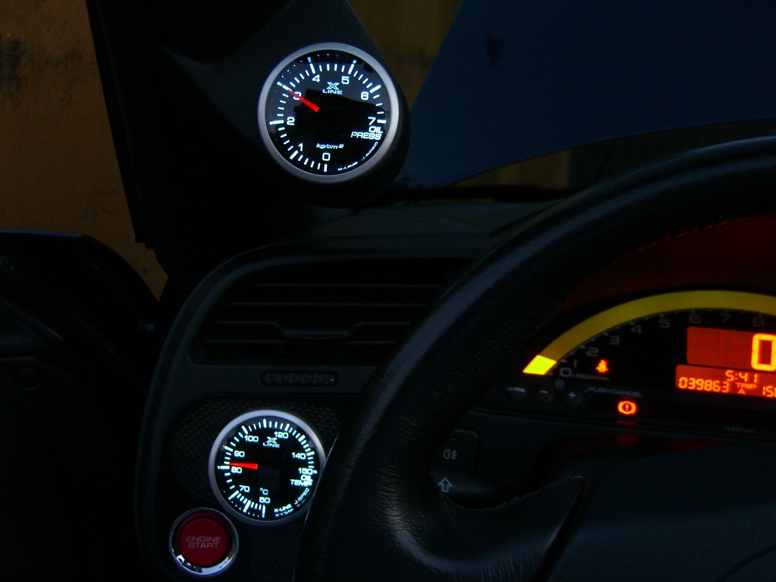

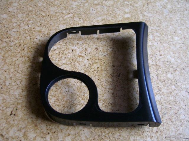

    Why are the 2 positions of the gauges so far away from each other? :?:
    No triple gauges?
    Einmal editiert, zuletzt von lost-in-emotions (30. Oktober 2007 um 20:04)
  • super_2000
    644
    • 30. Oktober 2007 um 20:09
    • #11
    Original von lost-in-emotions
    No triple gauges?
    Hi!
    The air vent is in the way!!! :lol: :roll: :)
    Triple gauges all on one side would be too much for me.

    Regarding the oil pressure: (we already discussed on the phone)
    Oil pressure according to the service manual:
    at idle speed 2.5 kgf/cm²
    at 3000rpm 6.0 kgf/cm²
    so yours is fine!
    I wouldn't know what the triple gauge would be for - except for a hidden view through your windshield :lol:
    No it's cool that you only have a single gauge pod! :thumbup:

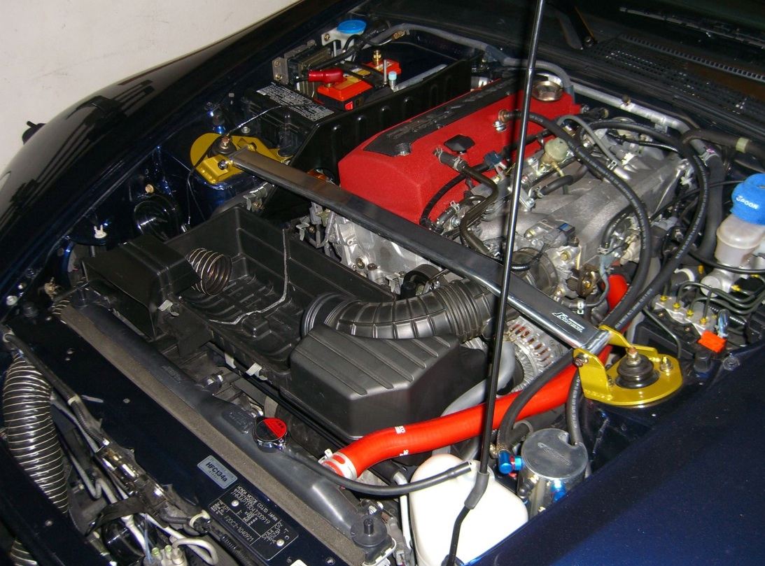

    At which location does your airhose run through to the engine bay?
    Einmal editiert, zuletzt von McHeizer (31. Oktober 2007 um 00:02)
  • super_2000
    644
    • 1. November 2007 um 19:28
    • #14
    Thanks for the helpful info dude! :thumbup:

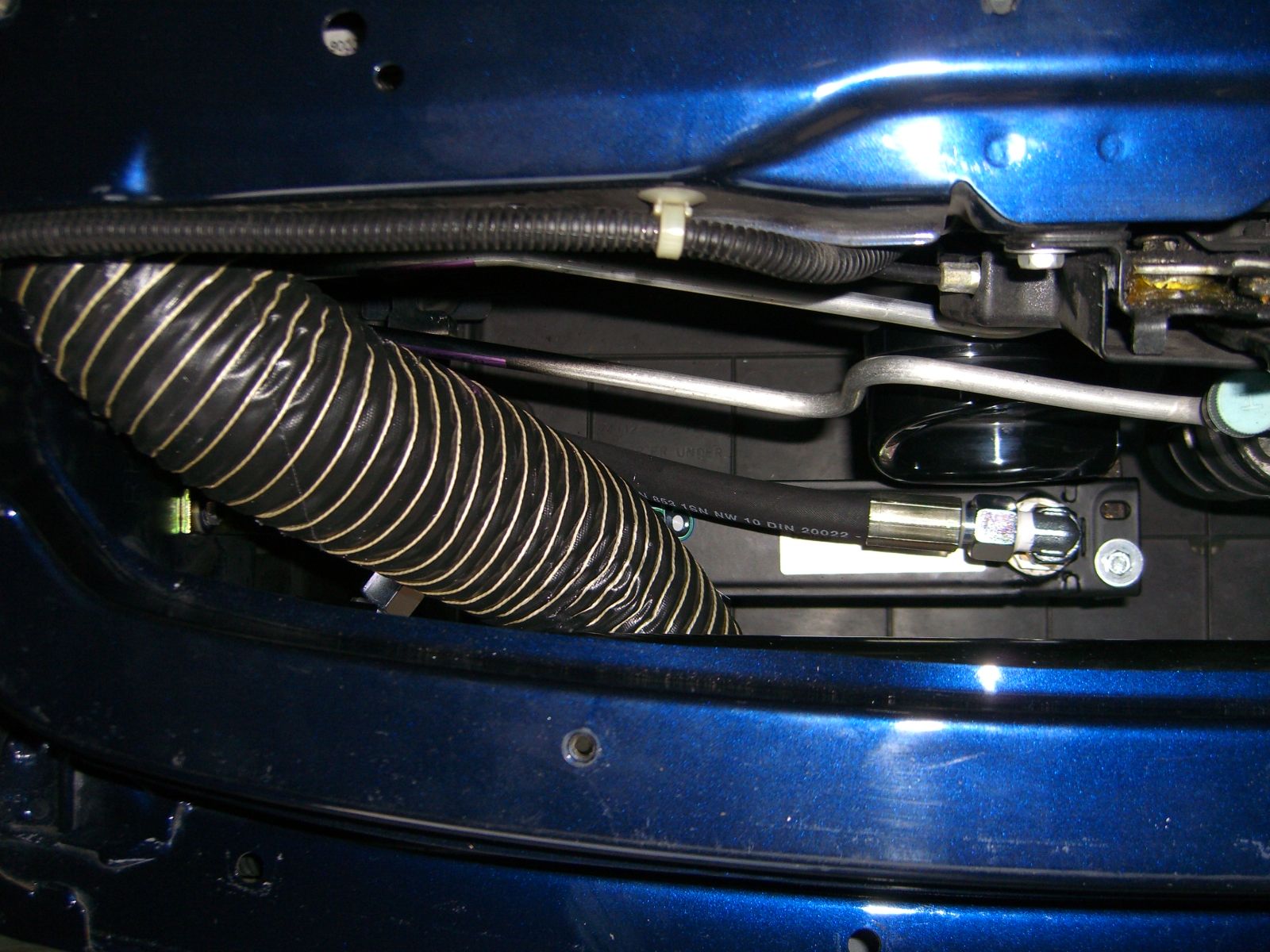

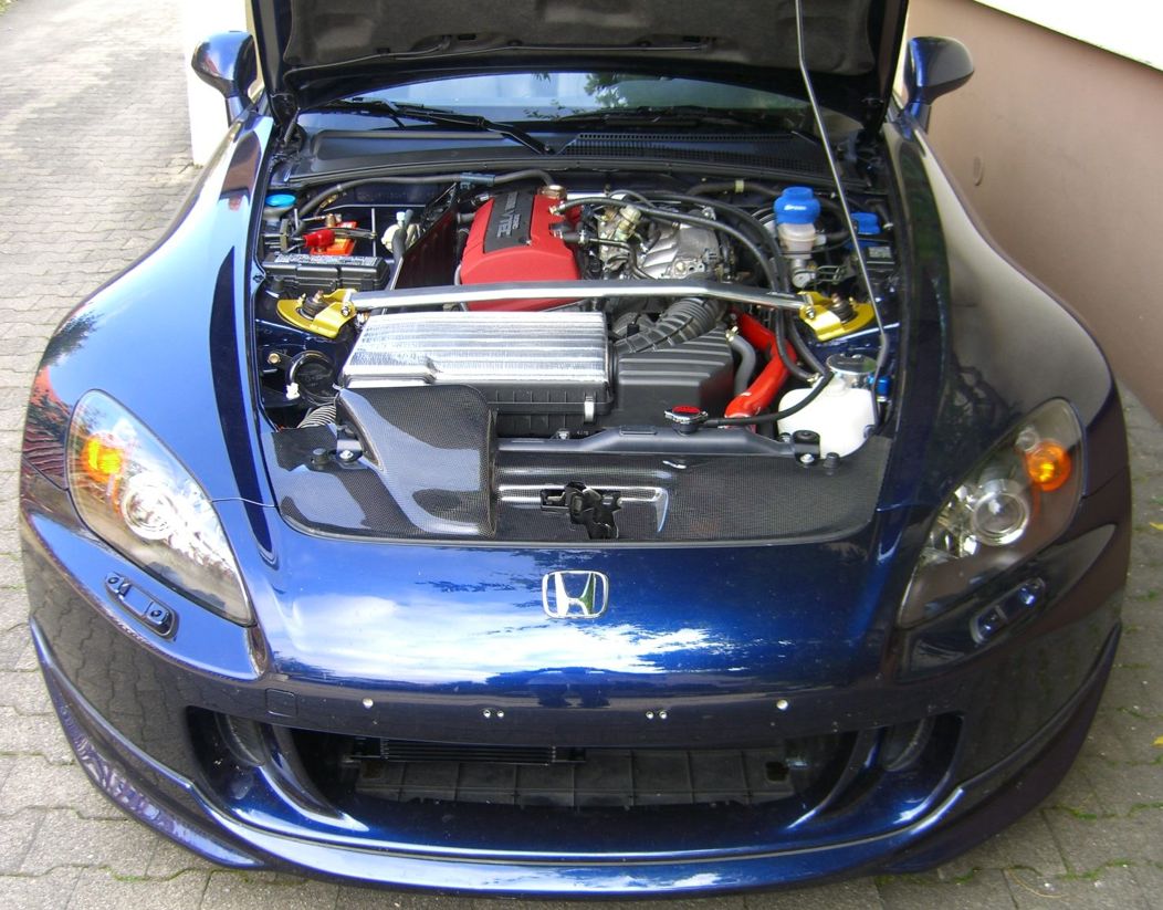

    Here is a pic of how I routed the hose to the airbox. This was the only possibility that I found to fit the 70mm hose through. It was a very tight fit. I simply wanted too much fresh air for my filter...... :D

    Perfect!
    you know I did the same thing, right? I guess you got the idea from my car ;)

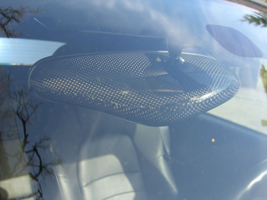

    The 2008 season gives me more mods for my S! :) I hope this year I will lower my S but only time will tell.....for now are some small but effective changes! The 70mm Spoon throttle body will soon follow 8)
