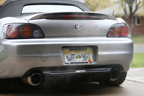

    Glaubt irgendwer das Teil bringt was? Von der Optik her nicht schlecht!
    APR
    bringt zwei Sachen:
    1) sieht ganz ok aus und fürs Gewissen hat man nen Vorteil
    2) erhöhte Diff-temperaturen da weniger Kühlung, evtl werden diese zu hoch :thumbdown:

    You could drill 4 large holes in the diffuser under the diff for some extra ventilation and less weight..... just like what we did in RC racing..... :)

    airflow and aerodynamics is a bit more tricky to solve than just drilling 4 holes :roll:
    I don't know man it's your call, but I wouldn't run it without at least a diff-temp-sensor in some way :nod:

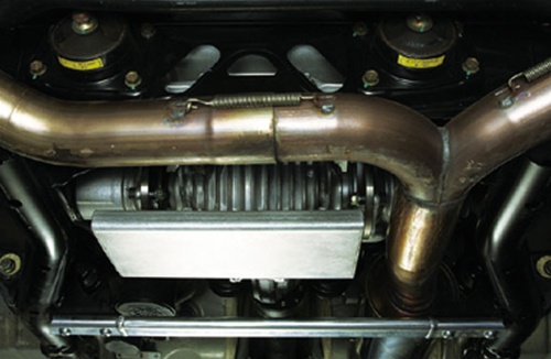

    This would be the most professional mod for cooling the diff. It also looks like it would clear the APR diffuser. Gonna research that.......
    Not really dude. The most professional is with an external oil cooler.
    But therefore you need an electrical pump, hoses, fittings, wiring, and a good location for all of that. :o
    Then again I might be too sceptical or over-engineering stuff.
    You might get away with that large oil-reservoir housing. Spoon offers it for $700 :roll:
