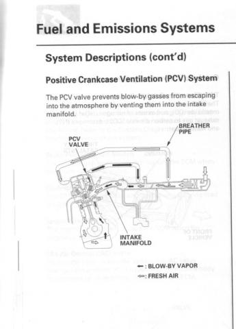

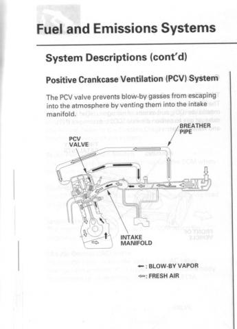

  • Hier mal ein Posting von FPerra, was die Dinger genau machen und was der wesentliche Unterschied zum herkömmlichen Stock System ist:
    And here is my take on it. The PCV system we see in all emission control cars today is designed to prevent the blow by gases from being vented to the atmosphere as they were in my more youthful days (anyone remember valve cover breathers). The PCV system is not a performance enhancer. Because it recycling the blow by gases into the intake manifold, the octane rating of the fuel is reduced. The extent of this reduction depends on how poorly the piston rings are sealing. The blows by gases also add heat to the intake charge - another bad thing. But we have to live with the PCV system to keep Al Gore from going into another one of his rants. And you still have all these negative affects with the Krank Vent system.
    So let’s examine how each system works. The stock PCV system first: During idle and partial throttle operations, the flow of gases is from the front valve cover vent, which is connected to the intake right after the air filter, through the PCV, and into the intake manifold. The driving force for this flow is the partial vacuum of the intake manifold. At full throttle, there is no vacuum generated, the PCV valve shuts, and the blow by gases are relived through the front valve coved breather and into the intake manifold. A simple closed loop system that works great doing what it was designed for - reduced emissions.
    Now the Krank Vent: During idle and partial throttle operations, the flow of gases is from the back side of the pistons (crank case blow by gases), through the PCV valve, and into the intake manifold. The driving force for this flow is the partial vacuum of the intake manifold. There is no flow through the front valve cover breather because the Krank Vent valve connected to it is kept shut by the partial vacuum. At full throttle, there is no vacuum generated, the PCV valve and the Krank Vent valve connected to it shut, and the blow by gases are relived through the front valve coved Krank Vent, which is no longer held closed by the vacuum, into the intake manifold.
    So, from an EPA standpoint, what’s the difference? Not a whole lot except the Krank Vent system is better at getting rid of blow by gases. With the stock system the flow of gases occurs mostly in the valve cover area – fresh air mixed with blow by gases which rise to the valve cover area by convection. In the case of the Krank Vent, all of the flow is blow by.

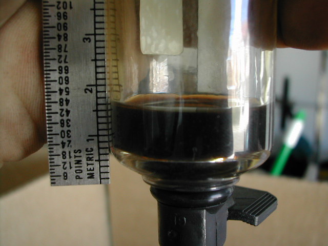

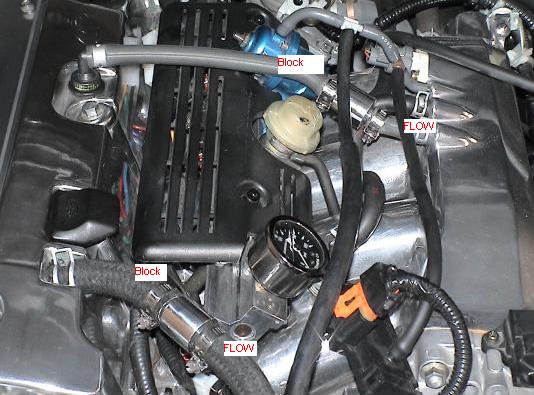

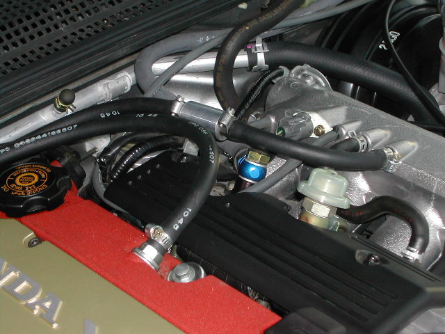

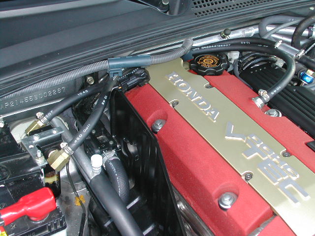

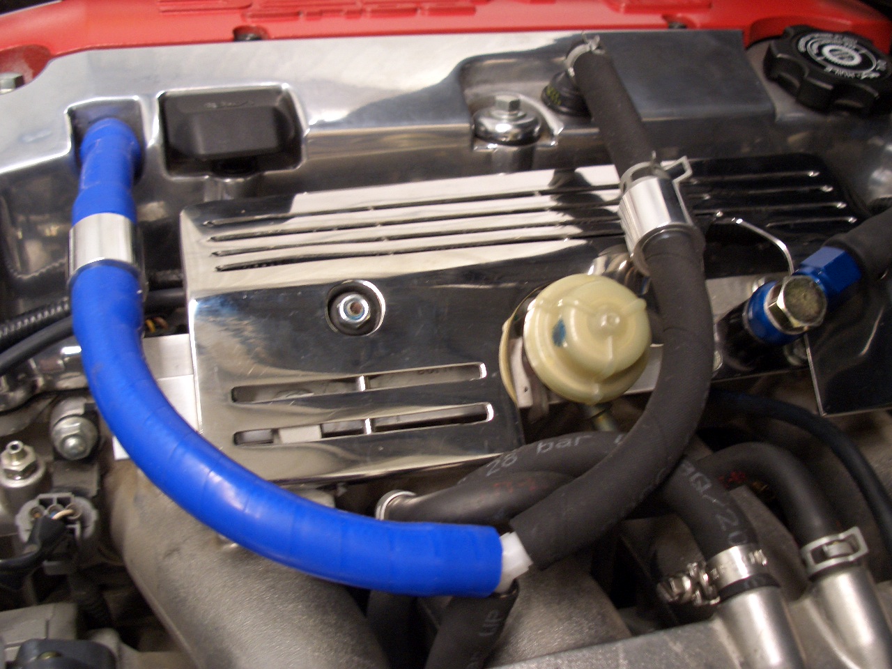

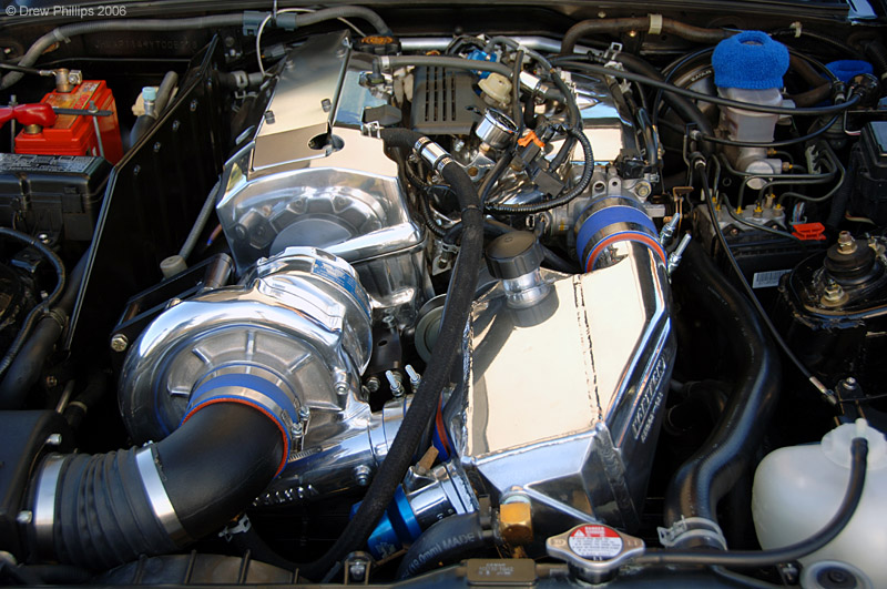

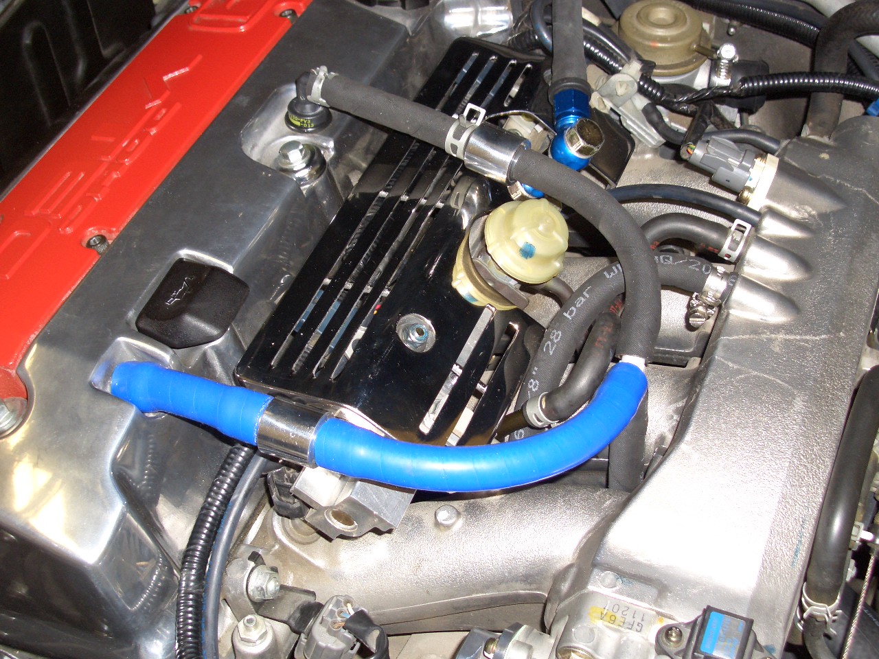

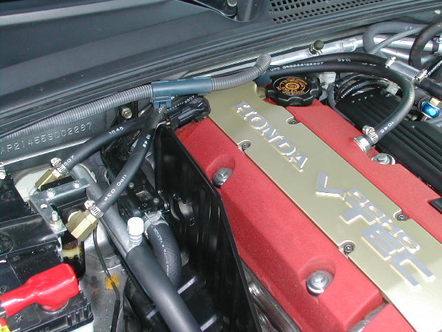

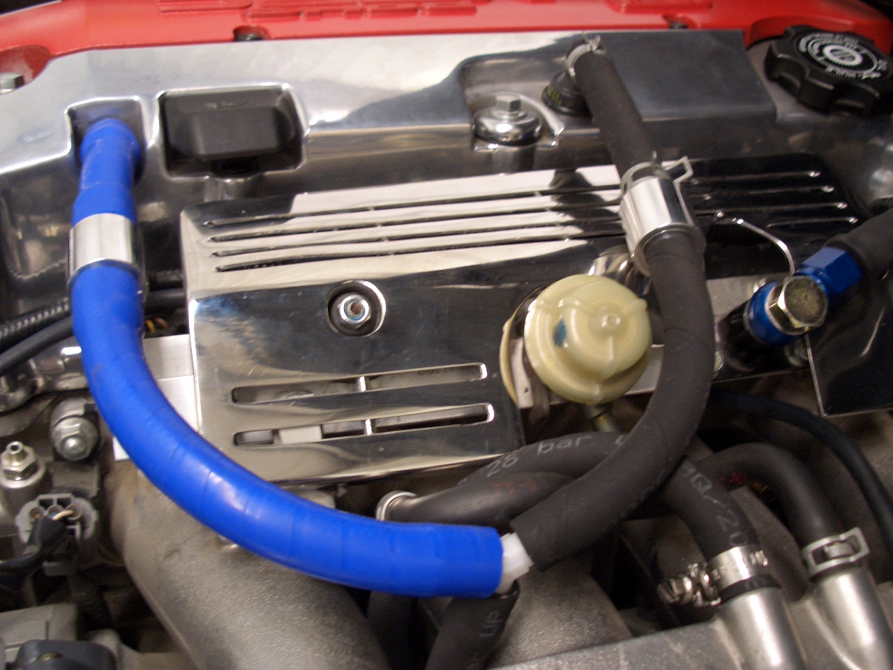

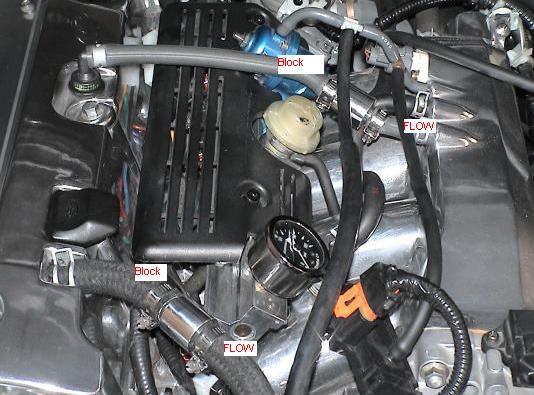

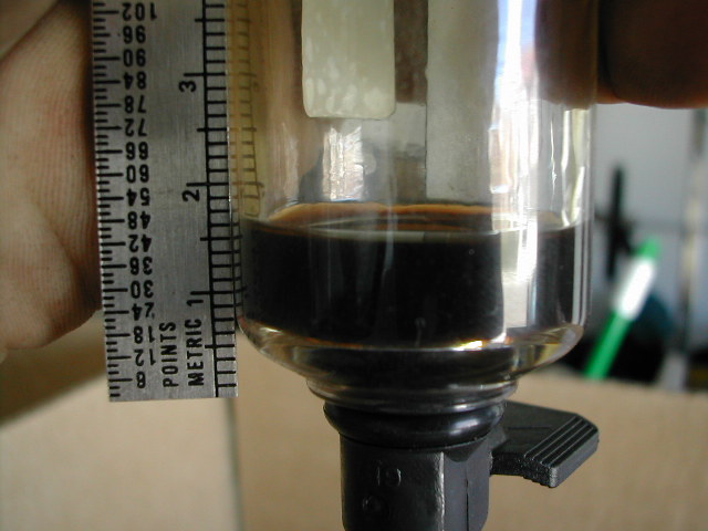

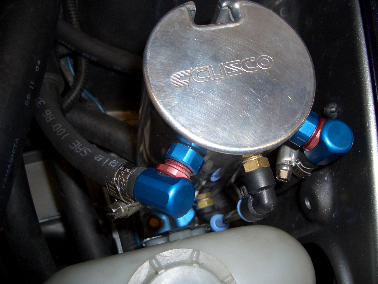

  • ... damit man auch sieht, was die meinen
    Krank Vent Setup Picture:
    Kranvent at the pcv:
    Inline catch can:
    Accumulated blowby:
    Man sieht hier auch sehr schön noch die Installation in Verbindung mit einem Oil Catcher und die gefangene Menge.
    Bei einem User gabe es eine 30 PS Mehrleistung, nur durch die Installation beider Krank Vents. Da frage ich mich doch, wieviel ich bei meinem Setup dadurch verliere ????

  • Servus!
    leider kann ich keine umfangreichen Erfahrungen mit aufgeladenen Motoren vorweisen, aber:
    So wie ich das verstehe verhindert dieses Ventil daß der im Saugrohr nun herrschende Überdruck in das kkurbelgehäuse (Nockenwelle/Kurbelwelle) entweichen kann. (Über die Schläuche im ersten Bild))
    Dann kann ich mir auch vorstellen, daß der Überdruck dadurch höher wird, wenn weniger entweichen kann, und somit mehr Leistung rauskommt...

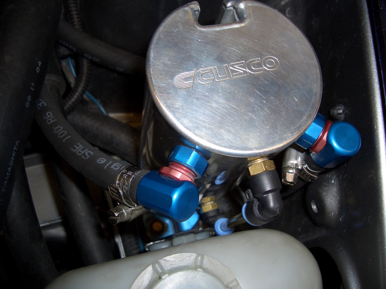

  • Im Prinzip geht´s darum das Du die "Blow by gases" aus dem Kurbelgehäuse
    nicht wieder dem Ansaugkrümmer zuführst sondern dieses Luft/Ölgemisch in einen Oilcatchtank sammelst. Bei nem aufgeladenen Motor besteht auch die Gefahr dass das eventuell zu schwache PCV (das one way valve auf dem Ventildeckel) zu schwach ist und die Ladedruck in das Kurbelgehause drückst.
    Original von A4XRBJ1
    Ok, also ein Must-have für aufgeladene S, oder?
    Mirko, was denkst Du, Groupbuy :lol:
    Ich denk ich werd beide Ausgänge einfach an einen Oilcatchtank verbinden und fertig!!
    Beim aufgeladenen S ist es einwenig anders. Du hast im Kurbelgehäuse einen Überdruck, den musst Du abführen. Beim S geht das über das PCV wieder in den Ansaugkrümmer aber nur um die aktuellen Abgasbestimmungen zu genügen, früher ging das über nen kleinen Lufi direkt in die Luft. O.k. soweit so gut nun ist aber bei nem aufgeladenen S der Ladedruck im Ansaugkrümmer höher wie der Überdruck im Kurbelgehäuse daher wird der nicht über das PCV abgeführt. Daher die Krank Vents bzw. das Abführen der Gase in einen Oilcatchtank.

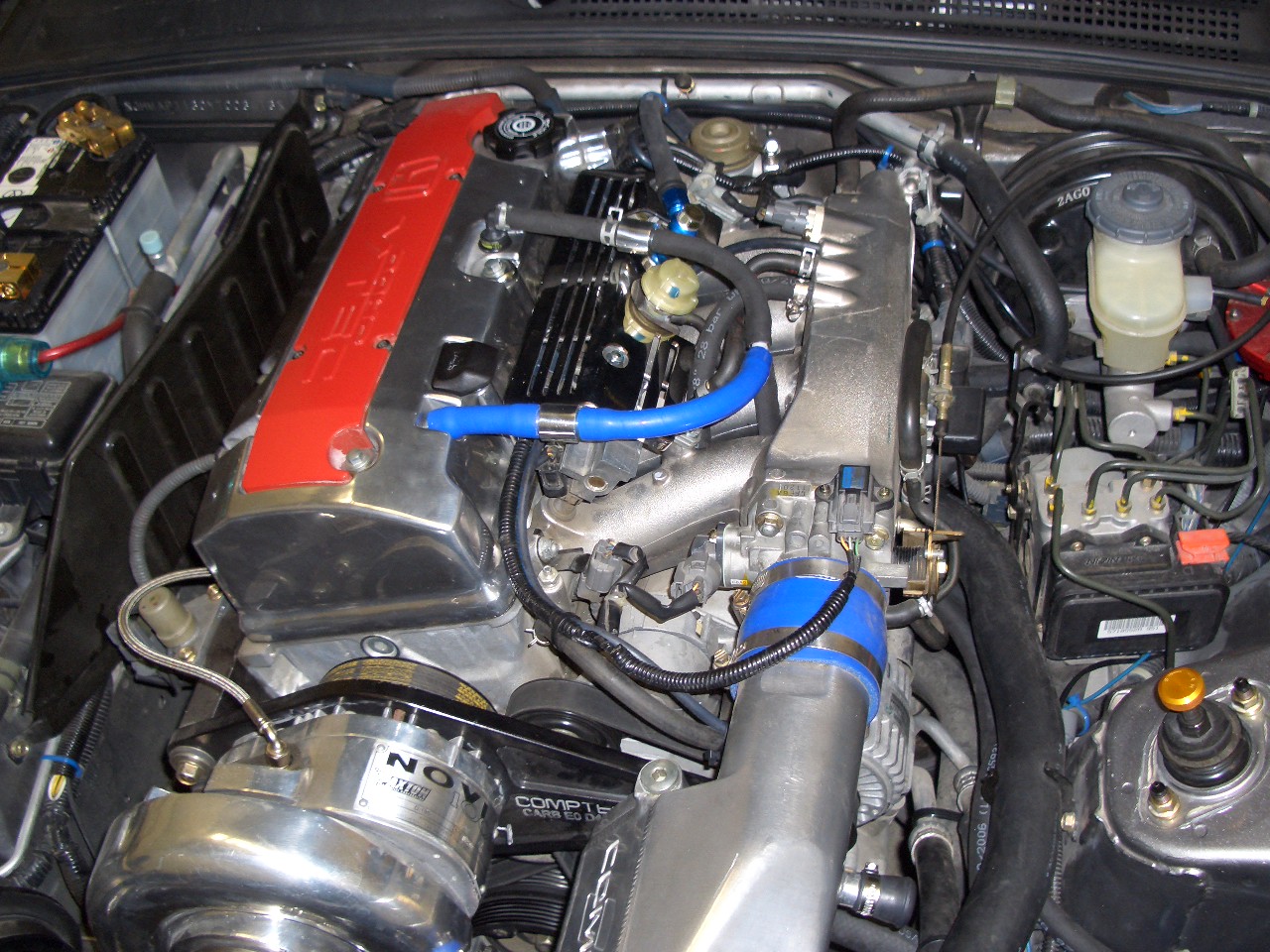

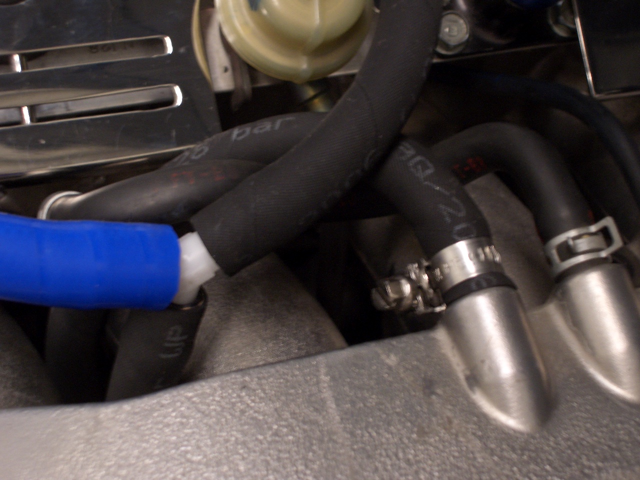

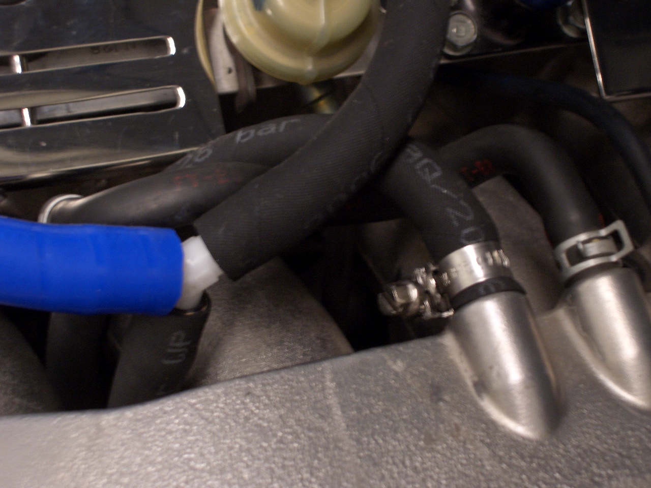

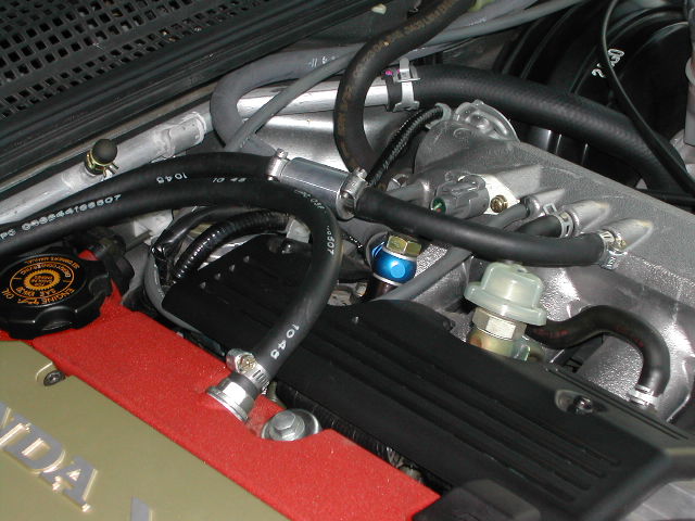

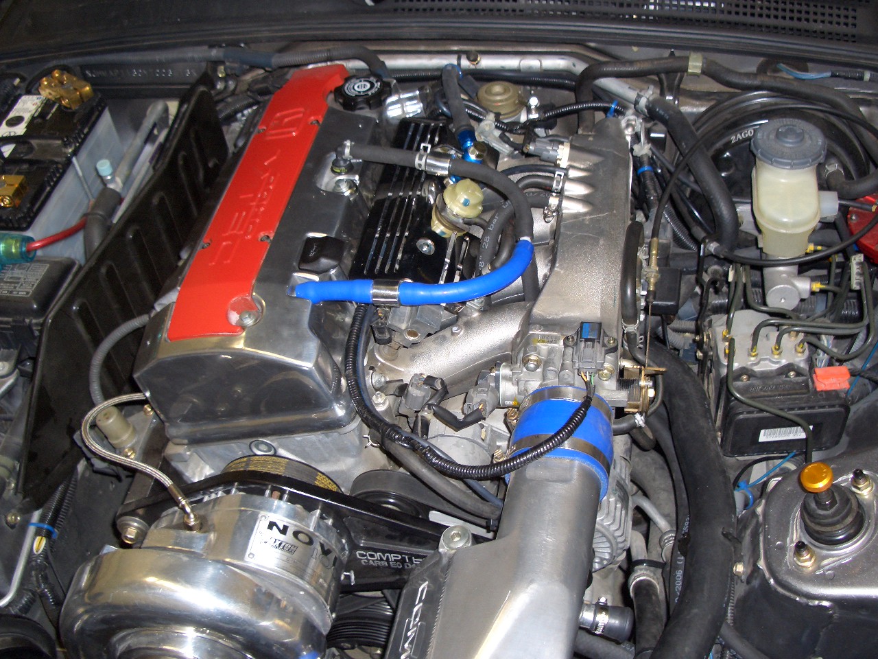

  • Ich hab mal einen Satz von den Krank Vents bestellt und verbaut.
    Und zwar den Oilcatch Tank jetzt richtig angeschlossen d.h. es ist jetzt ein geschlossener Kreislauf der auf der einen Seite am PCV angeschlossen ist und auf der anderen Seite an einem Unterdruckanschluss vom Ansaugkrümmer.
  • Der blaue Schlauch wird noch durch schwarzen ersetzt, der ist mir nur ausgegangen. ;)
    Im Prinzip hab ichs jetzt so angeschlossen das Überdruck jetzt aus dem Kurbelgehäuse via dem Oilcatch Tank in den Krümmer geht und das Krank Vent verhindert das mir Laderduck in das Kurbelgehäuse bläst.
