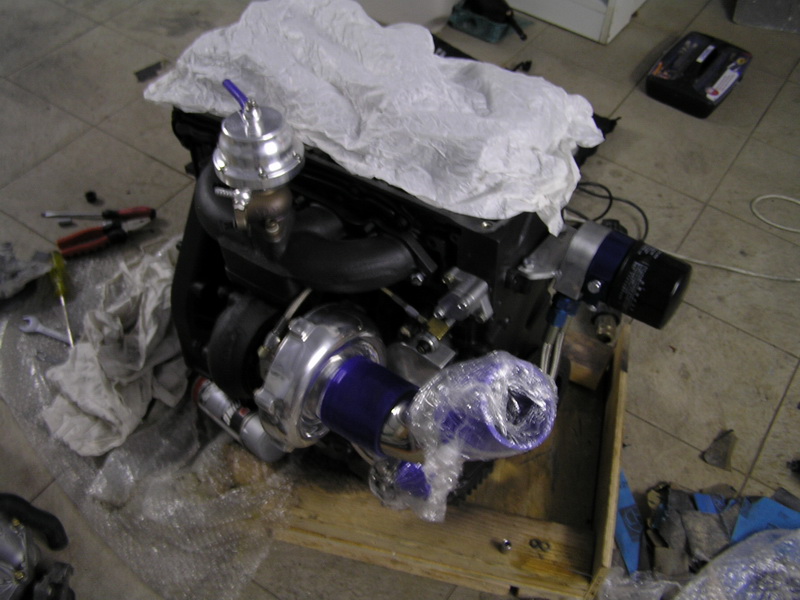

Nein, ich habe neuen Turbomotor F20C, komplet umgearbeitet in die US. Alle Teile sind neu. Nach einem Monat werde ich S Bj. 05 (AP2) auch aus der US haben.
I möchte einen SWAP F20C aus AP1 in AP2 S gemacht.

Whow...sieht sehr professionell aus! ![]()
Ich denke mal du hast dir das Inlinepro Turbokit geholt oder?
Was wurde denn noch gemacht? Block bearbeitet, andere Kolben, Pleul etc?
Würde mich echt interessieren. Gerade wegen der Abwicklung.

Block:
- AEBS T-sleeves engine work
- CP forged pistons 9:1 w/ rings
- CARRILLO forged rods
- ARP head studs
- ARP rod bolts
- ACL rods bearings
- ACL main bearings
- ACL thrust bearings
Head:
- FERREA competion plus stainless steel valves
- FERREA dual springs
- FERREA titanium retainers
- FERREA valve locators
- COMETIC head gasket
Boost:
- REV HARD turbo kit stage 2
- Turbo T3/T04E hybrid (60air)
- REV HARD cast iron manifold
- TIAL 35mm wastegate
- VORTECH blow off valve (BOV)
- Map bypass valve
Fuel & ignition:
- AEM EMS standalone 30-1052U w/ UEGO controller
- DENSO IRIDIUM spark plugs IK24 (1 step colder)
- RC 750cc saturated injectors w/ clips
- BDL fuel rail (titan)
- AEM fuel pressure regulator
- VORTECH fuel management unit (FMU)
- NOLOGY spark plug hot wires
- WALBRO high volume intank fuel pump 255lh
- B&M fuel pressure gauge
- Fuel rail adapter
- Steel fuel line
Cooling:
- KOYO aluminium radiator
- SEIBON SC carbon radiator plate
- SPOON thermostat (low temp)
- MUGEN fan switch (low temp)
- SPOON radiator cap 1.3bar
- HKS air filter
- Intake extreme gasket (block off the EGR)
- SPEARCO intercooler 27”x6.5”x3”
- Chromed IC 2,25” aluminized mandrel bent piping
- SAMCO intercooler silicone hose (blue)
- SAMCO radiator silicone hose (blue)
- SAMCO vacuum hose (blue)
- Big stainless clamps
Clutch:
- CENTERFORCE dual fiction clutch kit
- SPEC STAGE II clutch kevlar disc (torque cap. 425 ft/lbs.)
- SPEC high clamp pressure plate
- NUMBER #1 aluminium flywheel
- CUSCO RS 1.5way limited slip differential (LSD)
- Final gear ratio 4.44
- Stainless steel clutch line
Others:
- TEIN hood damper conversion
- Polished intake manifold
- Polished valve cover
- Carbon spark plug cover
- CUSCO oil catch can
- JS racing magnetic bolt
- Relocation oil kit
- Steel oil line
- Oil filter sandwich
- SPOON oil cap
- SPOON reservoir tank cover
- R1 WURKS high performance alternator pulley
- Krank vents
- AEM 3.5bar MAP sensor kit 30-2130-50
- AEM EGT sensor kit 30-2050
- AEM air inlet temperature kit 30-2010
- AEM boost gauge
- AEM EGT
- BLITZ SBC i-Color boost controller
EXHAUST:
- Custom downpipe 3” stainless steel (polished)
- ULTIMATE RACING 3” high-flow stainless steel catalytic converter
- ULTIMATE RACING 3” stainless steel exhaust catback w/ AP2 OEM tips
- MAFIA 3” test pipe
- THERMOTEC exhaust header wrap
SUSPENSION:
- CUSCO front strut bar
- KYOKUGEN lug nuts
BRAKES:
- BREMBO BIG BRAKE KIT front brake 4-pistons (red calipers)
- BREMBO front drilled rotors 12,9” (328x28mm)
- GOODRIDGE front and rear steel brakelines
- TRINET rear drilled rotors
- COMPTECH rear relocation kit with drilled rotors
- EBC green stuff rear brake pads
Kosten? Sehr viel :-))) Viewiel PS? Mit serien 7PSI ca 380PS, Maximum mit diese Turbolader T3/T4 ist ca 420-430ps.
Turblader wird im Sommer für GT35 ball bearing wechlest.
Halten sie Daumen ![]()
Ich habe in der US altere Motor geakuft. Ich habe ihn zu meinem Freund geshcikt. Er hat den Umbau mit TRT AUTOTECH verabredet. Es dauert ca 8 Monaten ![]()
Viele Geld, Stress, Zeit... ![]()
