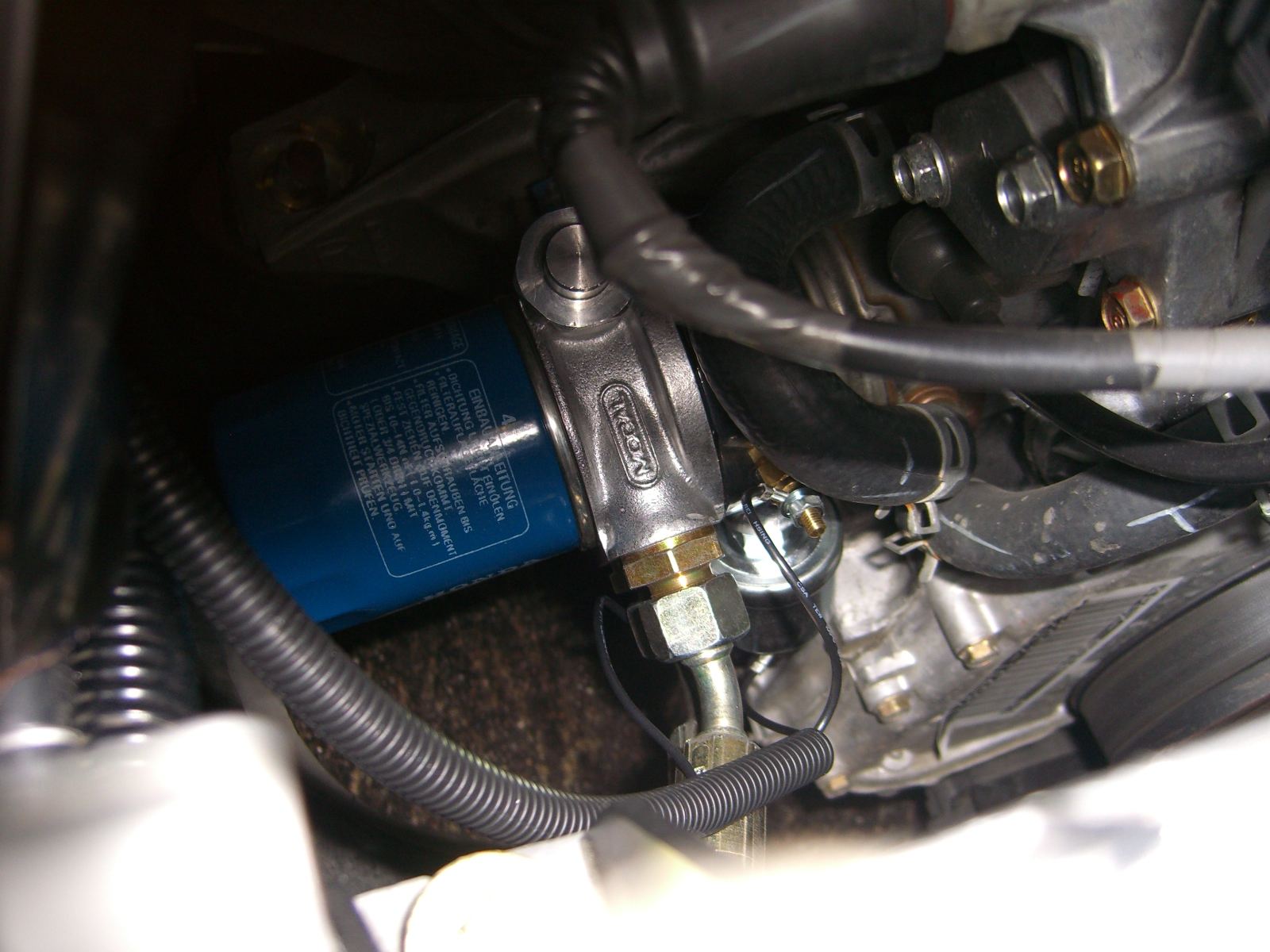

Hi Micha B!
Yesterday I was at the HHR and drove some laps. I noticed the same problem when I reached VTEC and the car sounded different, plus I felt a slight power decrease. I thought this was because I over-reved in 3rd for 2-3 seconds, but normally this should be ok. S2H was together with me and mentioned to me that there was a thread about this VTEC problem.
So, I also have an oil cooler with a double sandwich adapter. I do not notice any problem in VTEC when driving off the track, meaning my oil temp. is under 110°C, but when I last drove on the NS and my temp. reached ca.135°C, I felt that the engine was not performing at it's best in VTEC mode. Yesterday at the HHR I noticed exactly the same problem. Under 110°C VTEC was strong but as soon as I reached ca.130°C it started to struggle. This problem only happens on the track under tough conditions.......
I believe bpaspi is right in saying that the "double sandwich adapter" concept is not a good one because of the lower oil pressure.
I will remove my douple adapter and build in a single one and see if the problem under high temp. disappears. I believe it will. If not, then I'm just gonna get a complete new system from Greddy!
It's time for a re-build!
Here is my current set-up.

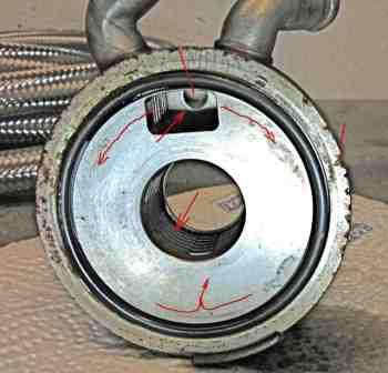

ZitatAlles anzeigenOriginal von Micha B
Zumindest mal ne Zeichnung aus m WHB:
Teil Nummer 13
Hier ist mal ein Bild vom Pipi-Ringlein
Das kalte und zähfliessende Öl kann nur durch die 5mm Bohrung durchflissen, da die seitlichen Kühlkanäle zu dünn sind. Sobald das Öl wärmer und damit dünnflüssiger wird, kann das Öl auch seitlich durch die Lamelle fliessen um sich dann unten wieder zu treffen wo ein rechteckiger Ausschnitt das Öl Richtung Ölfilter fliessen lässt.
Kein Wunder dass das Teil jede Menge Druck kostet....
Ist ja hochinteressant!
Aber ist der Ölfluß nicht genau anders herum? Kommt nicht in der Mitte durch die Hohlschraube das Öl von der Ölpumpe?
Das würde den hohen Druck am Fühler erklären, der ja dann quasi "vor" dem Pipiringlein kommt, und den darauf folgenden zu geringeren Druck im Motor, nachdem sich das Öl durch das Ringlein gedrückt hat.
Zudem ist mir jetzt auch klar, warum der Öldruck (am Fühler / VOR dem Pipiringlein) bei kaltem Öl so hoch ist... weil dann eben alles durch das 5mm "Löchlein" muß.
Das Teil kann bei warmen eigentlich nur geringfühgigen Druckverlust erzeugen. Bei warmen, laufenden Motor mit entsprechender Drehzahl wird genügend Öldruck erzeugt der auch , im OEM-Zustand, mehr als ausreichend für den Vtec-Schaltpunkt vorhanden ist. Der Fluß durch die Lammeln kann man druckseitig vernachlässigen.
Ja schon, der Druck wird auf jeden Fall erzeugt und lässt sich auch messen, aber die Engstelle von 5mm Durchmesser bleibt drotzdem! Und die begrenzt eben den Druck dahinter, egal ob es danach oder davor durch die Lamellen geht oder nicht.
Jede Engstelle erzeugt Verluste und Verwirbelungen, und damit verringert sich der Druck dahinter.
Der VTEC-Schalter schaltet übrigens schon bereits bei 2,2 bar, also viel muß da hinten auch garnicht ankommen damits keine Fehlermeldung gibt.....
5 mm sind sogar recht viel und wie schon erwähnt ohne Relevanz für den Druck da an dieser Stelle konstant Öl fließt. Eine Leitung von einem separatne Ölkühler bringt deutlich mehr Verlußt da sich die Leitung unter der Hitze, wenn auch nur minimal, im Durchmesser erweitert und dadurch auf die Länge gesehen multipliziert.
