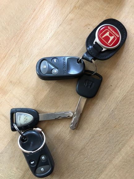

  • Seems many of us have different amounts of keys.
    Also with my 2006 modell I got only two. I checked the purchase contract and there is also mentionend two.
    But they are different, one black with one side ornament and one simple grey. But both with remote control. See attached pic for comparison.
    My first thought was the grey one is not opening the locked gloves box. But it has full funcionality - checked.
    Because with my 2003 Accord I got three keys, two "full" and one as a so called mechanic's key, not opening the gloves box.
    My 2008 CTR has also two "full" keys only.
    Anyway for me two keys are good to survive
    As Alex got two keys only as well - we have same years - I am wondering if Honda started cost savings during the course of production somewhen.
