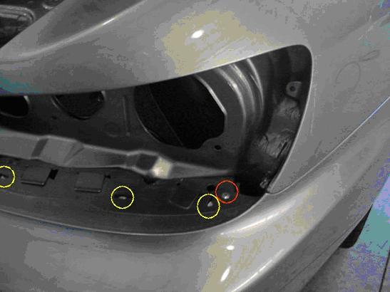

    For those that would like to know all of you, probably), the body shop claims the primary culprit in this whole issue is the three tabs under the tail lights that set the mounting location of the bumper. Apparently, when the bumper heats up, if flexs a bit, and the tabs can pop out (this is what i noticed, since my bumper first got bad in the summer heat...). Once they pop out, they don't like to go back and start to wear down... this also explains why some who have had the fix before see it come back... the shop simply remounted, and the bumper flexed again... POP! Problem comes back.
    So, what is the fix?... well, my shop added two rivets to the bumber to keep if from flexing up and poping out in the heat... some of you may not like the added rivets, but I felt all along that I could add a bolt or something and fix it if they couldn't... just means that if I ever need/have to replace/swap/whatever the bumper, I will have to drill a rivet... to me that is minor to have this fix on a car I plan to keep for a long while.
    Anyway, here's a shot that the body shop manager took for me while the bumper was off... The three tabs that are suspected are circled in yellow, and the added rivet is circled in red. This is also the fix that the shop did on half5dime's yellow S2K. (Reason mine went so quick is that they firgured it all out on half5dime's last week.)
    I think that the pic shows pretty well how there is only on tabs that sets the left / right location... and if it goes... well, you know. I do see that there is a tab that holds the bumper in, and it would appear difficult for it to flex and pop out, but I guess it did.

  • Ja, hat wirklich funktioniert, sogar sehr gut :thumbup:
    Du hast aber die falsche Jahreszeit für diese Maßnahme ausgesucht, weil der bumper an dieser Ecke wirklich nur absteht wenn er sehr warm wird.
    Wenn die Werkstatt einigermaßen fit ist müssen die nur die Rückleuchten ausbauen und als Tip gesagt bekommen, dass man die beiden Blechteile miteinander vernietet.

  • Das Foto ist von der Quali nicht so besonders, aber man erkennt das Wesentliche: Der rote Kreis markiert die nachträglich angebrachte Niete.
    Die gelben Kringel zeigen nur die Stellen an denen der bumper quasi draufgesteckt ist.
    Problem war ja, dass ab einem gewissen Bj ('04?) die seitliche Fixierung des Stoßfängers wegfiel.
    Man muss quasi die Kante des bumpers einfach in die korrekte Position drücken und dann an der rot markierten Stelle ein Loch bohren und eine Popniete befestigen.
    Zur Feinjustage kann man übrigens auch das darüber sitzende Stahlblech, also die Einfassung des Rücklichts, leicht verformen.
