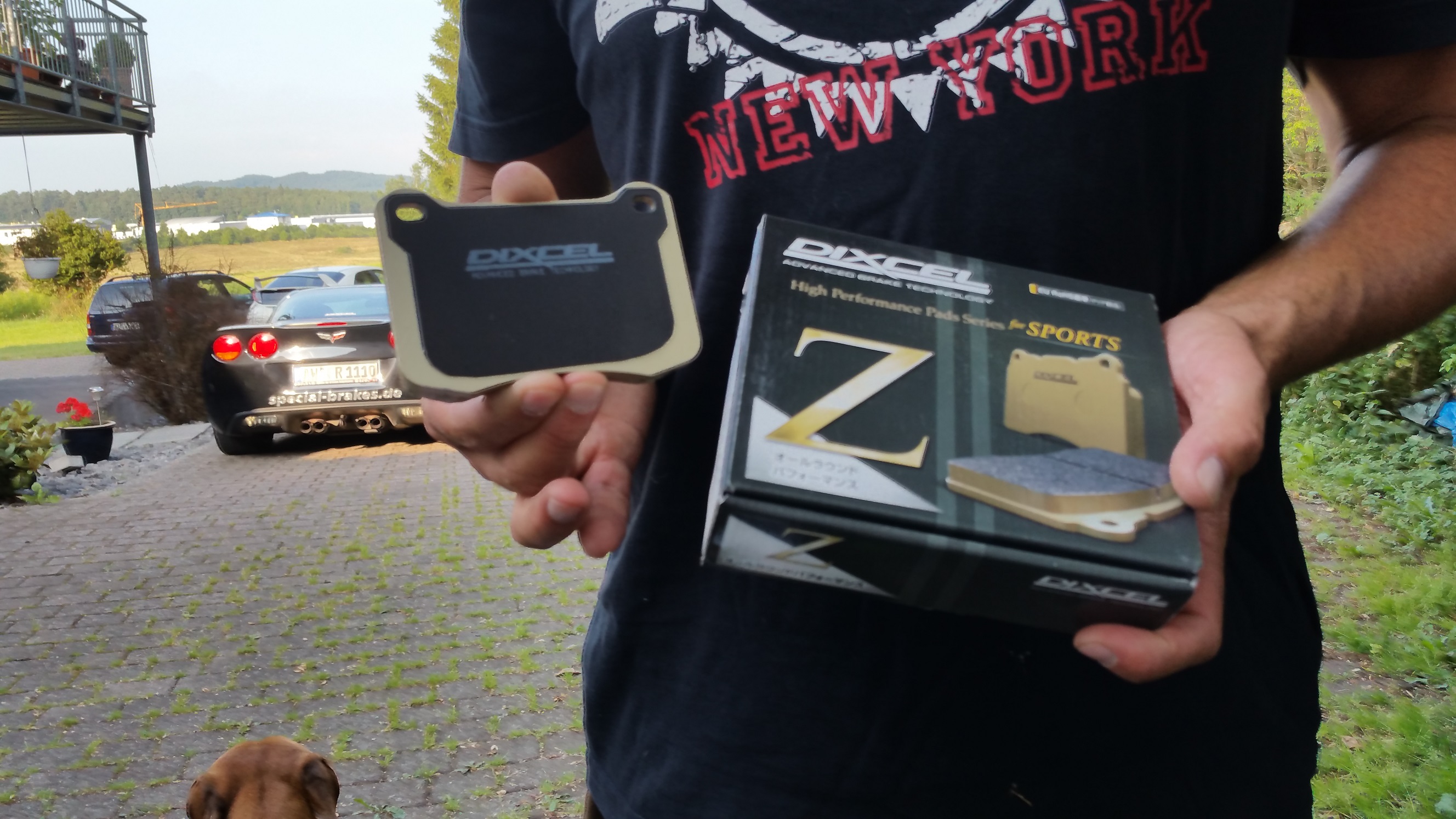

  • Dixcel fürn Track sollen :thumbup: sein und ja, ist JDM :D
    Mods: Mugen Intake/Header/Exhaust/Active Gate Rotors, Hondata FlashPro, Invidia 60mm Testpipe, Endless MX-72, KW V3, 17" CE28N, Michelin PS4, Spoon Gusset Plate, Spoon Rigid Collars, J's STB & ETD, Beatrush Braces, Fender Braces, Stahlbus Bleeder Valves, Radium '06 OCC, Vibra Technics Engine Mounts, Hasport 62A Diff. Mounts, Koyo Radiator, Fluidampr, CR-Sway Bars.
