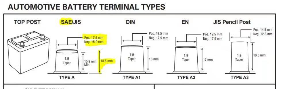

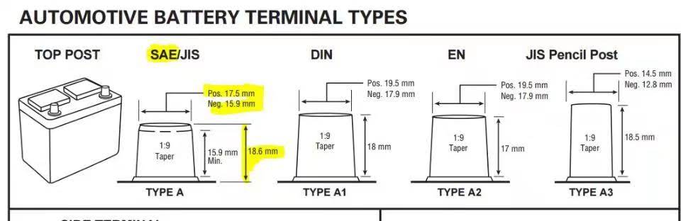

  • Hier meine Anfrage an den Hersteller ...
    1. „+“ Pole position is on left or right side?
    See pic below for pole orientation.
    2. Diameter of „+“ and „-“ pol in [mm]?
    See pic below for terminal size - SAE standard size highlighted
    3. 60 Ah (Pb equivalent) highlighted on the webpage. How much real capacity in Ah does the battery have?
    In the Touge 500, cell capacity = 20Ah; PbEq is reflective of the fact that our lithium cells is capable of delivering full crank current even whilst state of charge is low
    4. Permissible charge current (typ. and max.)?
    Max tested 150A continuous; S2000 charge current will be significantly below this.
    5. Suitable for Honda S2000 MY03 or any other battery recommended? Any modification required to the vehicle, e.g. charging system? Assumed to be fine due to BMS build into the battery.
    No modification required to use as our BMS are designed to work with automotive alternators.
